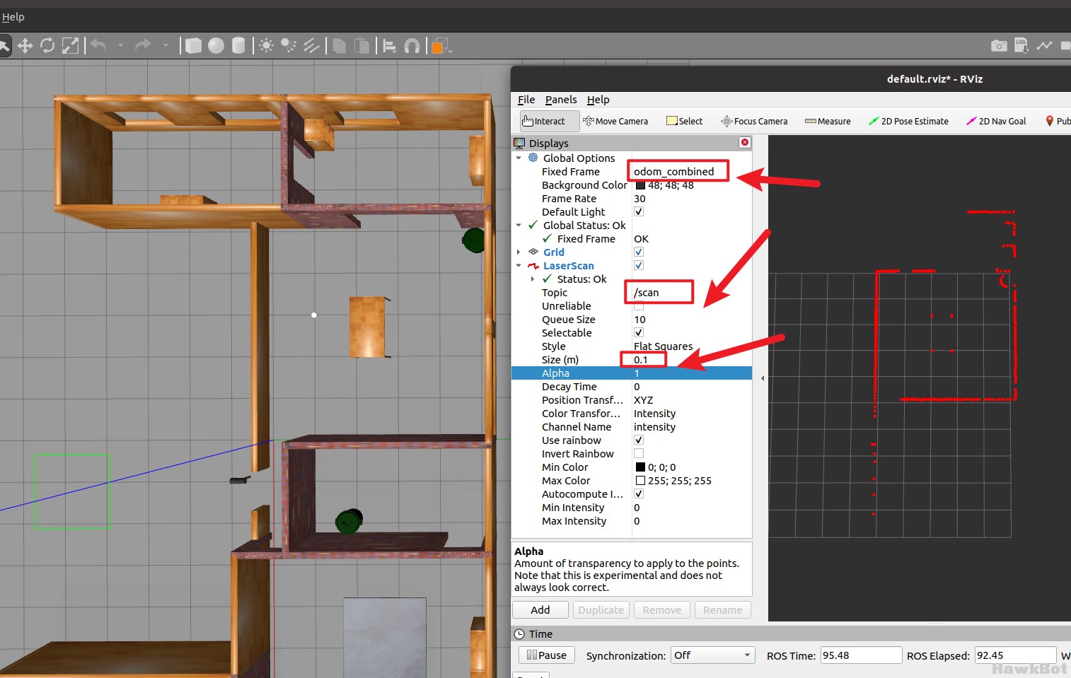

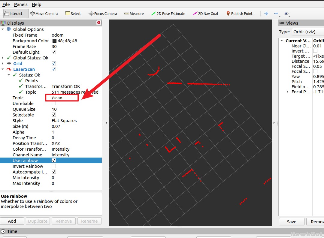

在仿真环境打开,且雷达周围有障碍物的情况下,可以通过rviz查看实时雷达数据。命令行输入rviz,并左下角add按钮,添加监听话题
先打开仿真环境
hawkbot@hawkbot-ubuntu:~/catkin_ws$ roslaunch hawkbot_gazebo hawkbot_house.launch
... logging to /home/hawkbot/.ros/log/1c7055de-3686-11ef-a404-5f7dd3a7c8e2/roslaunch-hawkbot-ubuntu-123407.log
xacro: in-order processing became default in ROS Melodic. You can drop the option.
started roslaunch server http://192.168.100.52:41907/
再打开rviz,并添加监听话题
